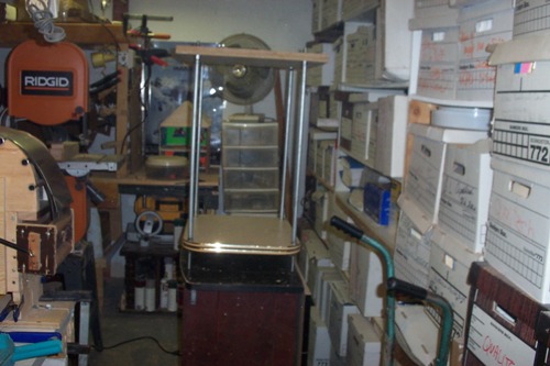

Hi Michael!
Here are a few shots of the construction of my deck, based on the model that Pat Foster showed here, it is very sturdy on both the top and bottom, 2 plates each were glued and 4 --1/2" theaded rods inside tubing and nuts to make it all secure

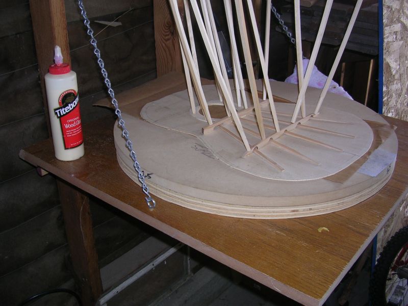

I used a portion of an old table top (28"x28") and mounted it on a wall with a hinge so it lays flat against the wall when not in use. To use it I lift it and have a light chain attached (at the two front corners) with eye bolts running up to the wall above it. Above the deck is a shelf that is my top. For rods I used 3/8" or 1/4" strips I ripped from a pine board.

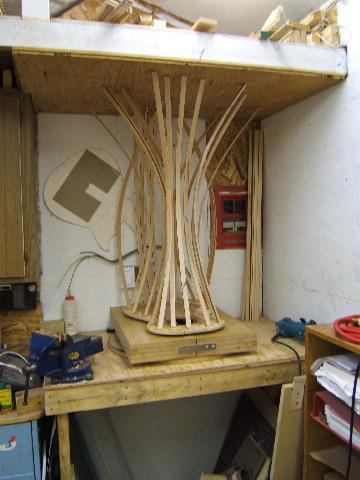

Here's mine, it's part of my bench area and the underside of my loft
PostPosted: Sun May 28, 2006 2:24 am
I found that by using tubing as spacers between the top and bottom, such as Todd has, and putting them under compression from the nuts, the deck was less wobbly, though strength is not affected. The spacer on the bottom is used when gluing braces and is removed for gluing the top and back.

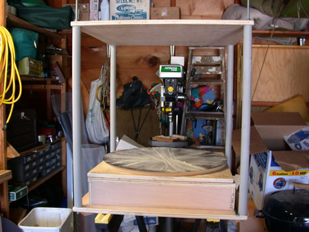

PostPosted: Sun May 28, 2006 4:15 am
I used 1" metal conduit for my struts, and ran 1/2" all thread through it. The top and bottom are just 1" screwed/glued MDF boards left over from basement renovation, in a 2' square pattern. I used big flat 2" washers to sandwhich the top and bottom, and that's it. The thing is total overkill, and it's so heavy I don't like lifting it...BUT I did it just make sure the deck is sturdy enough handle all the rods. Here's why: The first one I used wasn't sturdy enough to handle the combined pressure of the rods, and I'd get 7 rods in, and the 8th rod would be the one that slightly bent the top and BAM, those prior 7 would go shooting out all over the place. Very, very aggravating.
